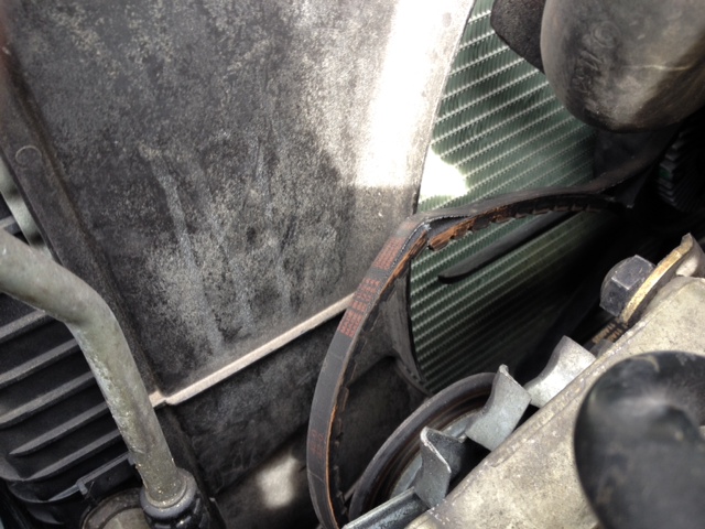

<p dir="auto">Once I got stopped, I saw green coolant leaking onto the ground. Popped the hood and don't see where it's coming from. No steam or anything. I did notice that my alternator belt is quite loose, maybe broken. Not sure if that would have caused all of this or not.</p>

<p dir="auto"><a href="/assets/uploads/files/monthly_10_2014_post-2609-0-03123200-1413047434.jpg"><img src="/assets/uploads/files/monthly_10_2014_post-2609-0-03123200-1413047434_thumb.jpg" alt="post-2609-0-03123200-1413047434thumb.jp" class=" img-fluid img-markdown" width="640" height="480" /></a></p>

<p dir="auto">Option number two seems really similar to my circumstances. Not sure if the alt bracket broke or came loose, or if the belt simply broke due to age. My hope is that the alt belt simply broke. I didn't replace it when I did my timing belt a year ago due to limited funds. I have no idea how old the belt is, or any of the other rubber parts under the hood. I've been meaning to start replacing them little by little, but just haven't had the money lately. I should probably replace both the alt and power steering belts while I'm under there. </p>
<p dir="auto">I did look at the overflow tank to check the level, and it's still pretty full. I checked the car about an hour after I parked it, and there wasn't a lake of coolant under it, so I think all that leaked out was just from pressure due to heat and the engine running. Almost sounds like coolant blew out of the overflow tank hose. I suspect that if one of the heater hoses had blown off of a mount on the firewall that it would have dumped a whole lot more coolant than it did. Also, my coolant level warning light never came on the entire time. Only the dash lights came on.</p>
<p dir="auto">Although I didn't take the cap off, the coolant didn't appear foamy or anything. Looked normal from what I saw just looking through the side of the tank from the outside. Will pull the dipstick first thing tomorrow and check that. I plan on changing out the belt, and checking the heater hoses near the firewall just to make sure none of them blew off. It's easy to think the worst right away, but I've been working on cars long enough to know that often it's something really simple. Replacing a busted belt is about as simple as it gets. I can only hope.</p>
