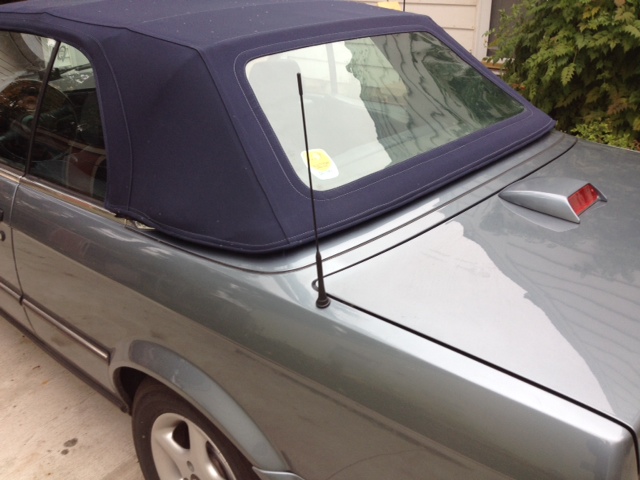

]]></description><link>https://wibimmers.com/topic/1942/e30-antenna-alternatives</link><generator>RSS for Node</generator><lastBuildDate>Wed, 16 Sep 2026 05:51:49 GMT</lastBuildDate><atom:link href="https://wibimmers.com/topic/1942.rss" rel="self" type="application/rss+xml"/><pubDate>Thu, 03 Oct 2013 01:53:49 GMT</pubDate><ttl>60</ttl><item><title><![CDATA[Reply to E30 Antenna alternatives on Wed, 16 Oct 2013 18:19:44 GMT]]></title><description><![CDATA[<p dir="auto">Here is a pic of the new antenna on the car.</p>
<p dir="auto"><a href="/assets/uploads/files/monthly_10_2013_post-2724-0-74715600-1381978379.jpg"><img src="/assets/uploads/files/monthly_10_2013_post-2724-0-74715600-1381978379_thumb.jpg" alt="post-2724-0-74715600-1381978379thumb.jp" class=" img-fluid img-markdown" width="640" height="480" /></a></p>
]]></description><link>https://wibimmers.com/post/29567</link><guid isPermaLink="true">https://wibimmers.com/post/29567</guid><dc:creator><![CDATA[6670charger]]></dc:creator><pubDate>Wed, 16 Oct 2013 18:19:44 GMT</pubDate></item><item><title><![CDATA[Reply to E30 Antenna alternatives on Wed, 16 Oct 2013 01:49:37 GMT]]></title><description><![CDATA[<p dir="auto">Ended up using the version that was posted in the Bimmerwerks site.  Cost me all of $30.  Looks and works great.  Found a used antenna from an E36 cabrio for $20, and antenna mast for $1, and got a brand new grommet for $11.</p>
