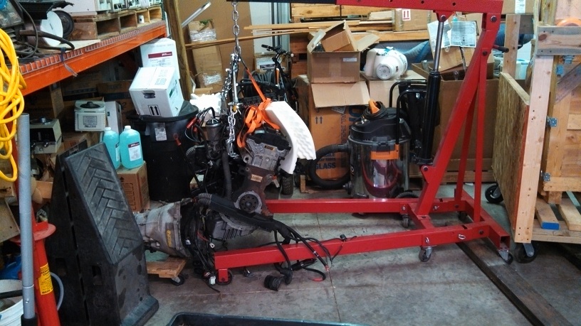

<p dir="auto"><strong><a href="/post/28235">M318 said:</a></strong></p>
<p dir="auto">Did you know that on <a href="http://bimmerfest.com" rel="nofollow ugc">bimmerfest.com</a> they were telling people to put their clutch disk in backwards to get rid of chattering. What do you think about that? Is it COMPLETELY ridiculous?</p>
<p dir="auto">This is correct if you are using the E34 M5 clutch and you can use the E34 pressure plate. You need an aftermarket flywheel so you can flip the clutch so it will lay inside the flywheel. I'm not familiar with your flywheel at all.</p>
<p dir="auto">It won't work lol. The flywheel bolts will run into the clutch disk.</p>

<p dir="auto"><strong><a href="/post/28204">M318 said:</a></strong></p>
<p dir="auto">MY BAD. I ordered the OEM M3 non sprung hub clutch with a single mass flywheel... I ain't down with chattering so I returned it... Now I am waiting on this...</p>
<p dir="auto"><img src="http://assets3.fcpstores.com/public/assets/products/48362/product/KF776-01.jpg?1329350881" alt="KF776-01.jpg?1329350881" class=" img-fluid img-markdown" /></p>
<p dir="auto">That dere is the E39 M5 Clutch and pressure plate. Looks like i am building it right. Probably wont even start.... anyway I spent way more than I planned <strong>but oh well whats money when it comes to your BMW!</strong></p>
<p dir="auto">Exactly.</p>
