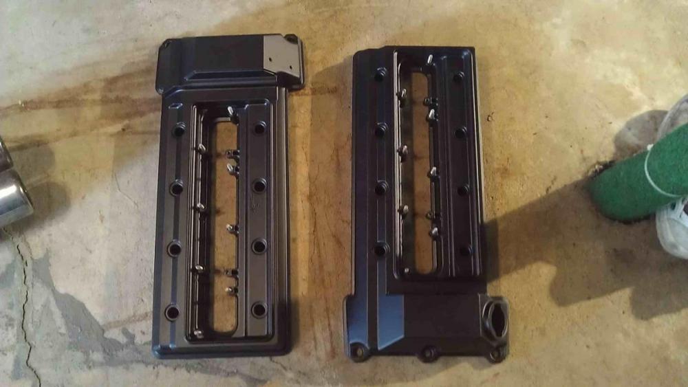

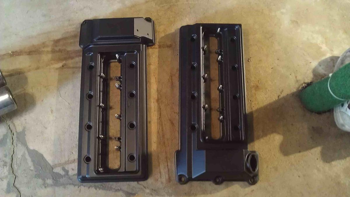

]]></description><link>https://wibimmers.com/post/26131</link><guid isPermaLink="true">https://wibimmers.com/post/26131</guid><dc:creator><![CDATA[240sxguy]]></dc:creator><pubDate>Wed, 31 Jul 2013 13:41:06 GMT</pubDate></item><item><title><![CDATA[Reply to Valve Cover Powder Coating on Wed, 31 Jul 2013 02:28:49 GMT]]></title><description><![CDATA[<p dir="auto">Sorry its been so long for the reply. I took the covers in on a Friday and they were ready for me on the following Wednesday evening. Overall, I am very pleased with how they turned out. The coating looks exceptional and it was done in a very timely manner. I am a little disappointed in the lack of communication that B&amp;K offered, however. I had emailed them as the first contact and received a response the very next day, stating that they would be willing to attempt it. I replied stating exactly what I wanted done and that they would be dropped off. I dropped them off that Friday. After hearing nothing for some time, I called on Tuesday and found out that they were already stripped and he would try to finish them by Wednesday. On Wednesday I was emailed that they were done. Despite the lack of communication without my nagging, I would not hesitate to do it again. I am very happy with the quality and the price seemed reasonable to me at $100. I would recommend to anyone considering getting their own powder coated.</p>
<p dir="auto">A few pictures: (don't mind the dirty plastic engine covers)  EDIT: Only one picture would upload for some reason. If you want more, I can PM them.</p>
