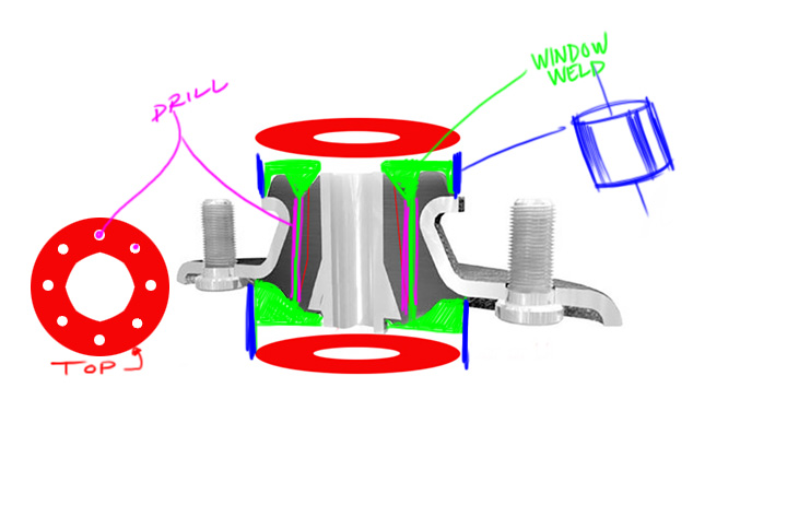

      As far as those rear mounts go, would it be possible to add some window weld for extra material support? I have used that stuff to make rare hard to find, or weak rubber/poly mounts strong again.
        #223
        +1 on that. I have done it too.
          #224

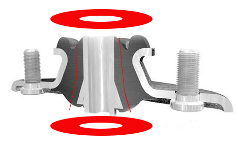

          how would that work?  I can't picture it.
          i've attached a diagram of an e30/e36 rear mount, which is the same principal as the e34. the rubber part of the bushing completely torn all the way around the center metal sleeve (red lines), separating the mount into two pieces. the only thing keeping the shock from separating from the mount completely was the washers on top/bottom that cant pass through the mount (show as red discs)
            #225
            You could do a few things. Obviously this is a bit of work, and if I was in your shoes I wouldn't do and of this. I would probably just take out all of the soft rubber material, take some measurements, go on energy suspensions website and find a bushing that would match the dimensions. If you don't do that, here is a quick idea of how you could use window weld. The blue tube could be welded around the material, or just used to contain it while you pour the part. I would also suggest drilling through the new mounts allowing the window weld to flow through the existing rubber on the mount.

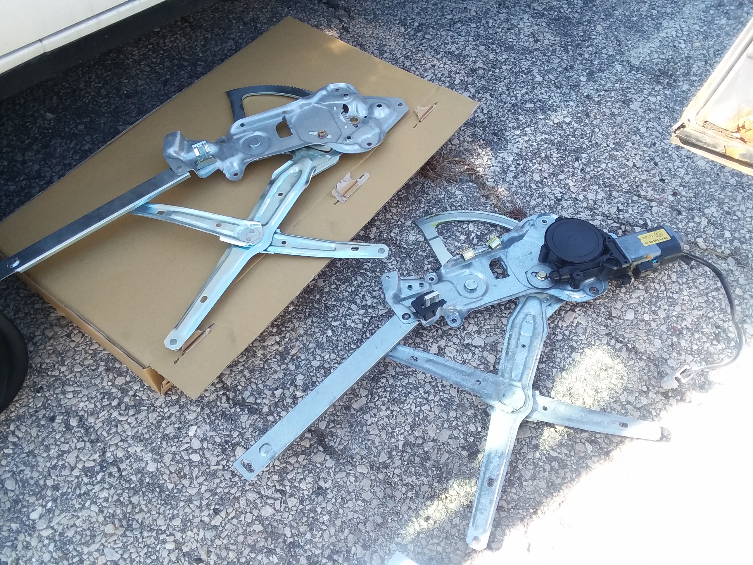

              in the saga that is my driver's window continually snapping clips and coming off the regulator, i decided to just replace the whole regulator to see how that goes. the regulator is slightly bent out of spec and my guess is its not allowing the torque to be applied correctly to the clips.
              hint: the e34 the regulators are riveted on. you'll need to drill em out and have 5x 10mm bolts/nuts for the new regulator. super easy repair on an e34 (no contorting your hands and cutting up your arms reaching inside the door skins)

                Where did you buy the regulator?
                  #228
                  oops, missed this.  i found it on ebay for cheap. fit perfectly, seemed as good quality as the BMW part.
