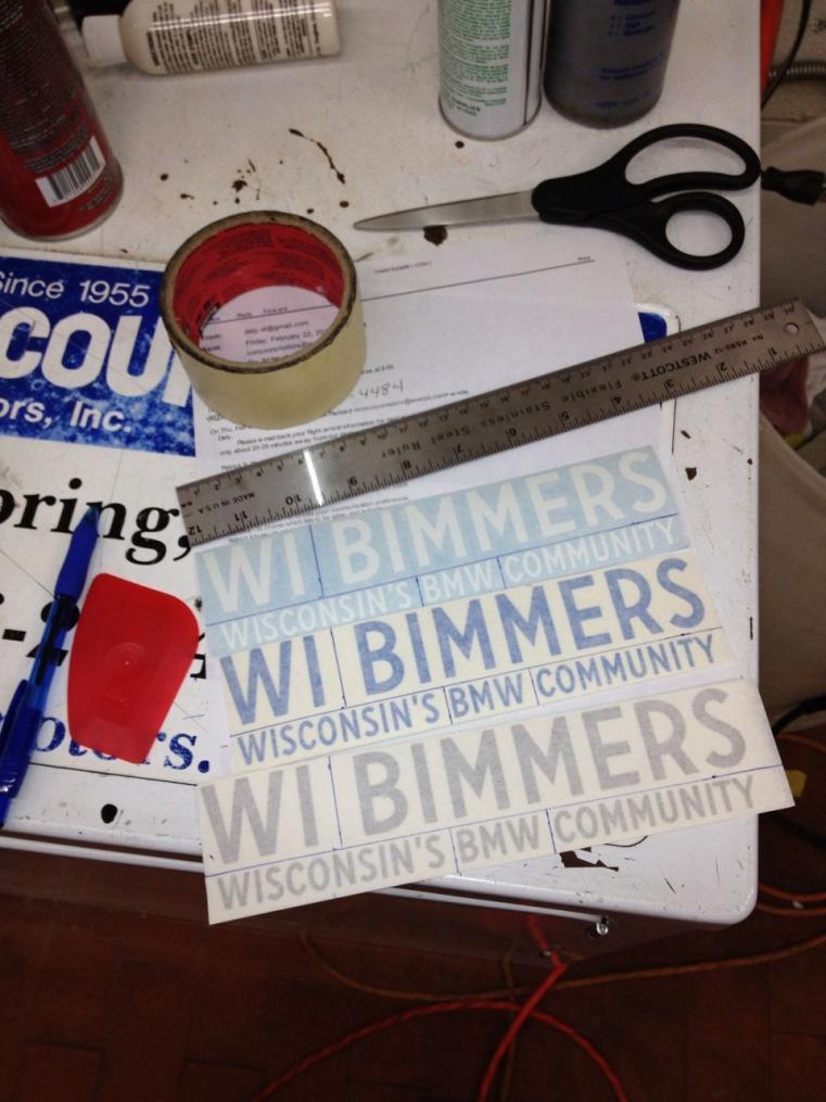

<p dir="auto"><strong>Step 2: Prep Stickers</strong><br />
Since we will be doing a mulit-color sticker install, each desired section to be used needs to be marked. The most accurate way to do this is to take measurements off the letter itself, as the paper surround the vinyl most likely wasn't cut straight or accurately. Measure out and draw identical lines for each sticker to be used. Below is a photo of how I divided each sticker so that "WI", "BIMMERS" and the slogan were separate colors.</p>

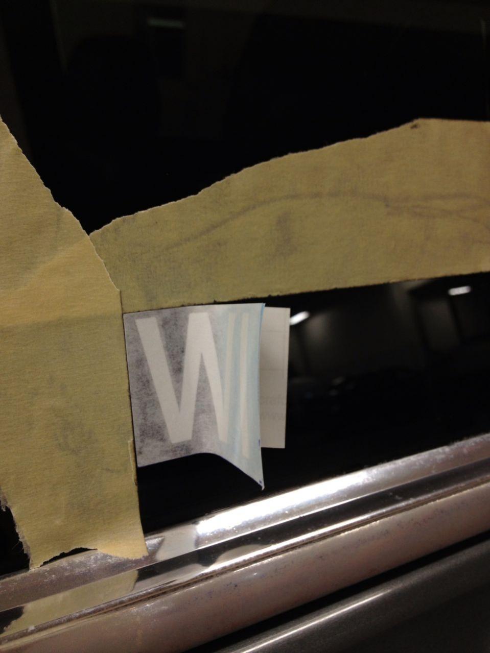

<p dir="auto">Now its time to place the first piece. Peel off the backing paper and crease it at a 45 degree angle. By doing this you will be able to more accurately align the transfer paper edge because it wont become askew. It is also beneficial when pulling of the backing paper to do it at a 45 degree angle as the vinyl will be less likely to stick and easier to transfer.</p>

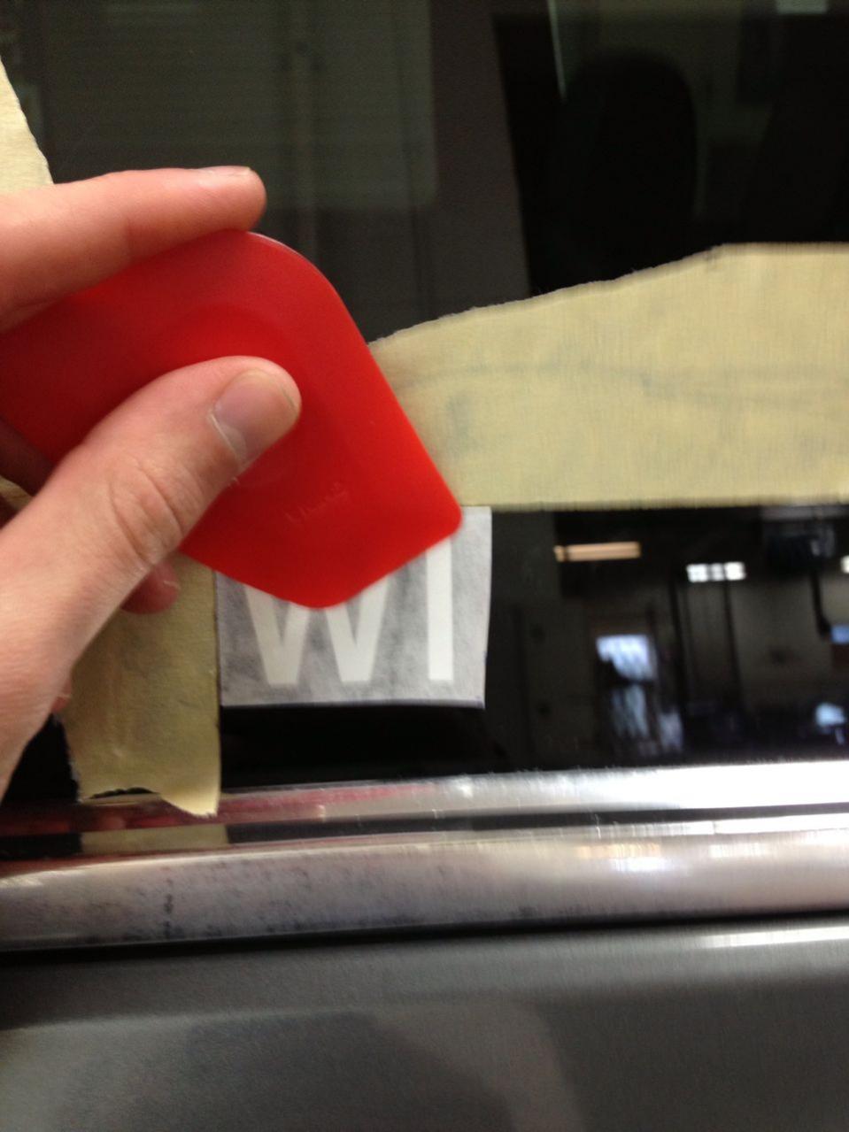

<p dir="auto">To make sure the vinyl has good adhesion, rub over the decal with a squeegee</p>

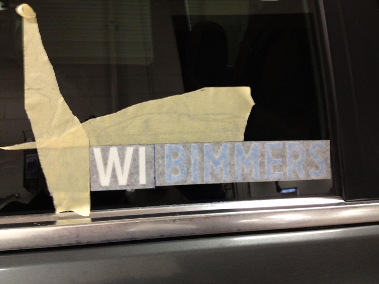

<p dir="auto">Repeat those steps for the second section</p>

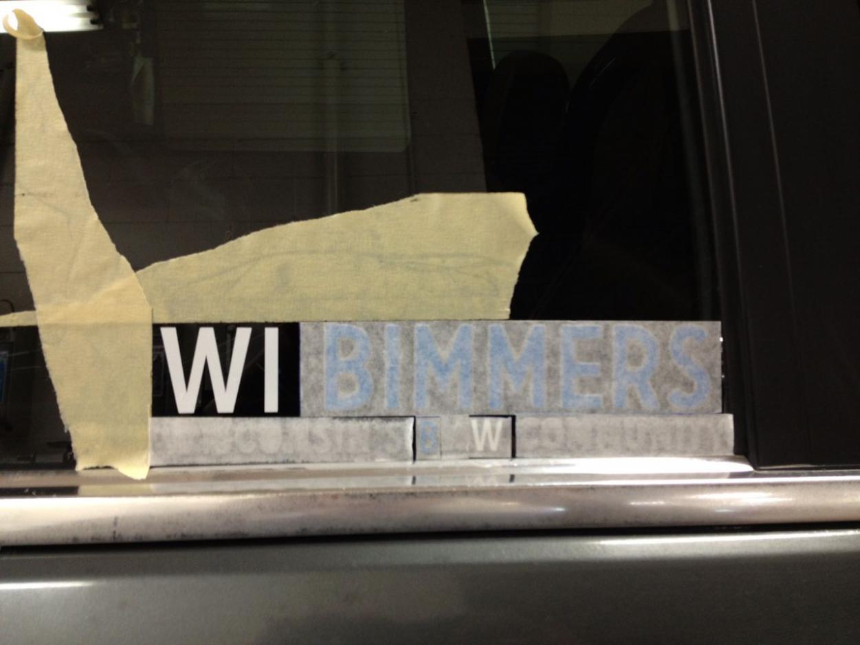

<p dir="auto">Zach wanted multiple colors on the bottom text also, I would not recommend this for beginners as the smaller things get, the harder they are to line them up.</p>

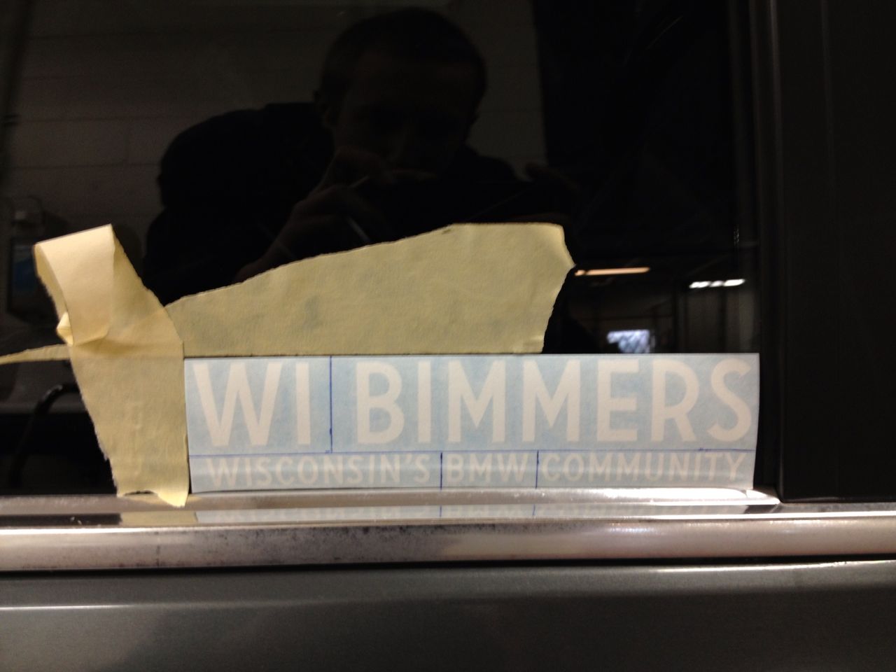

<p dir="auto">And the finished product!</p>
<p dir="auto"><a href="/assets/uploads/files/monthly_02_2013_post-786-136211551374.jpg"><img src="/assets/uploads/files/monthly_02_2013_post-786-136211551374_thumb.jpg" alt="post-786-136211551374thumb.jpg" class=" img-fluid img-markdown" width="1000" height="750" /></a></p>
<p dir="auto">While this looks cool up close, there isn't enough contrast between the blue and black tint from a distance that the "B" in bmw becomes hard to see. I wouldn't recommend changing colors on various letters like this but it was an experiment! I would recommend what I ended up installing on my truck, a simple 3 color layout.</p>
