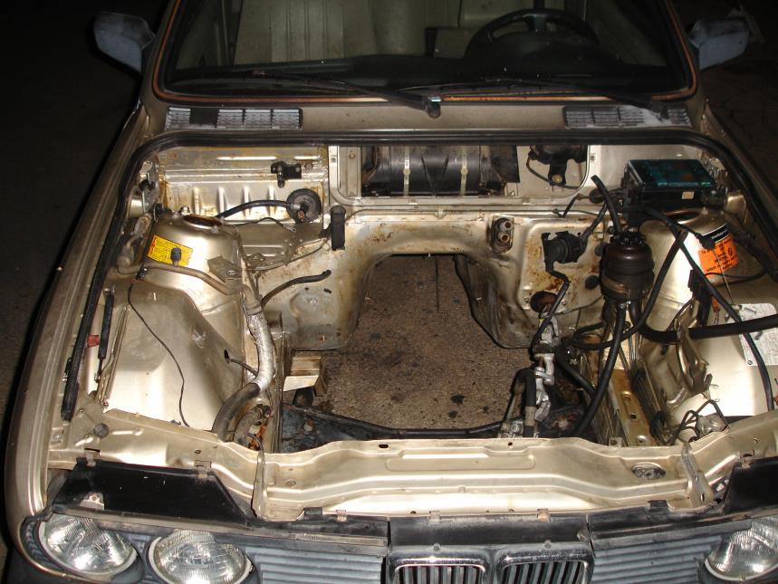

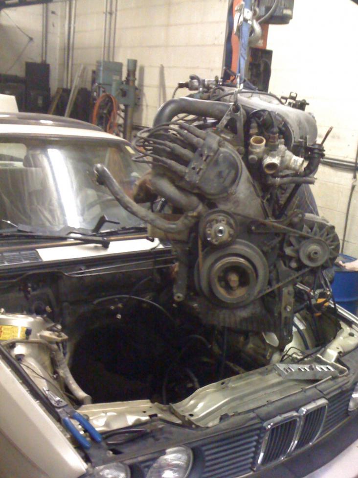

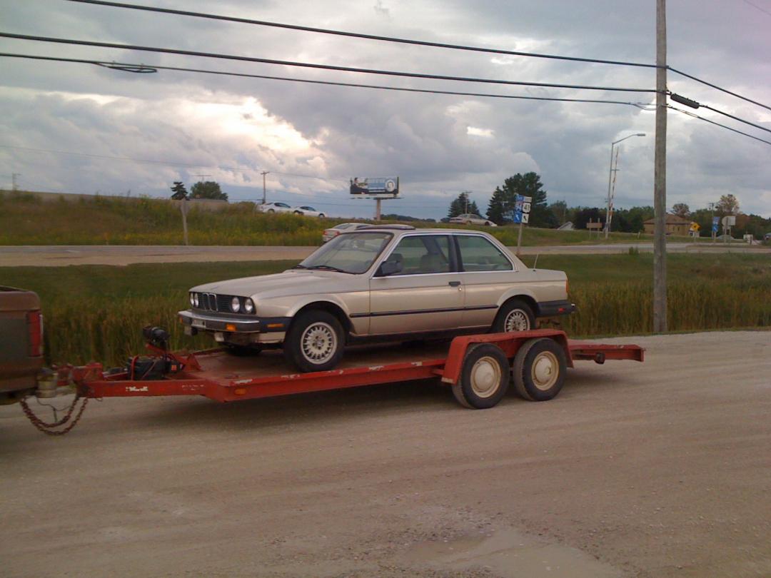

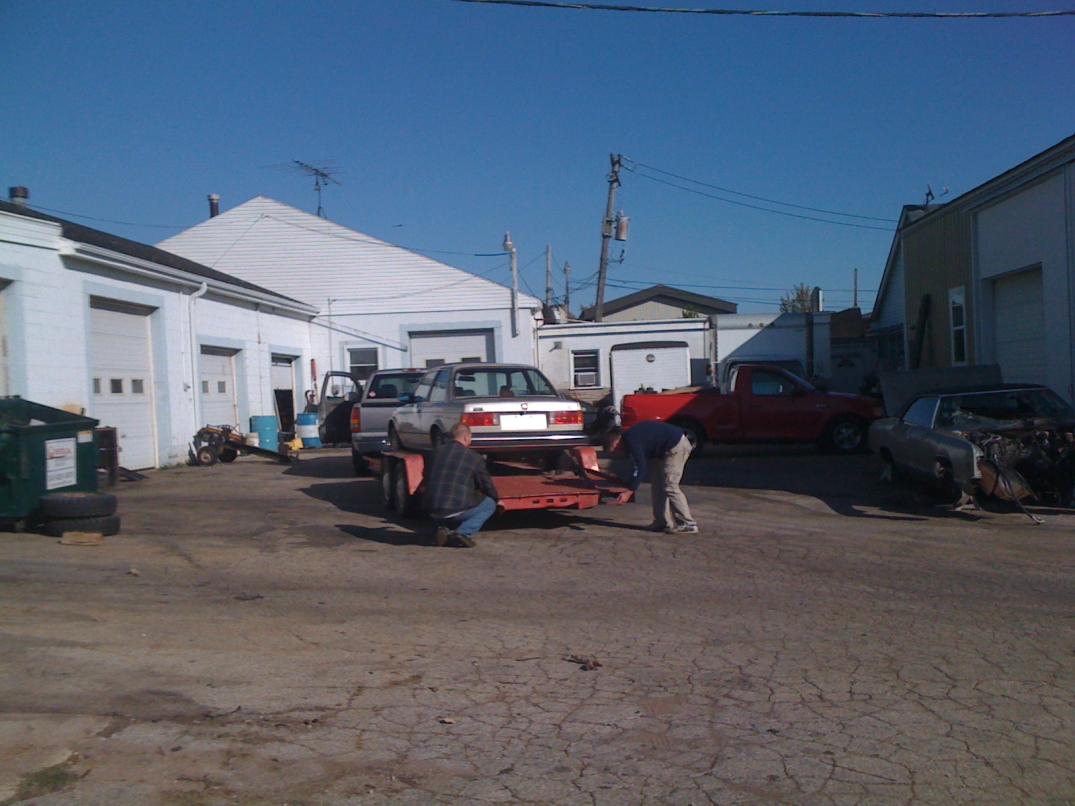

<p dir="auto">I picked up a pretty clean, southern, bronzit 2-door 87 325e about 1.5 years ago pretty cheap. It was not running and the auto trans was likely smoked from being tow dolly-ed it from SC to WI. The car was otherwise destined for the scrap yard, so I felt a little better about my plans for molesting it.</p>
<p dir="auto">Working with a relative's shop, we've added a MegaSquirt-controlled, single-turbo 302 with aluminum heads, EDIS and a massaged-in FMIC. I am using a WC t5, which is likely weak link that will need to be minded w/r/t driving style. Fuel, cooling and exhaust have been upgraded.</p>
<p dir="auto">It has been a casual build as the shop is a couple hours from me and family/work/travel make wrenching a once-a-month kinda thing. I benefit from a bro-in-law who has done quite a number of different swaps and is handy with the wring and MegaSquirt. The car is running but is in the tuning and clean-up stage. Idle is still rough so we have some troubleshooting to do. Suspension, brakes, wheels/tires will be addressed once it is driving.</p>

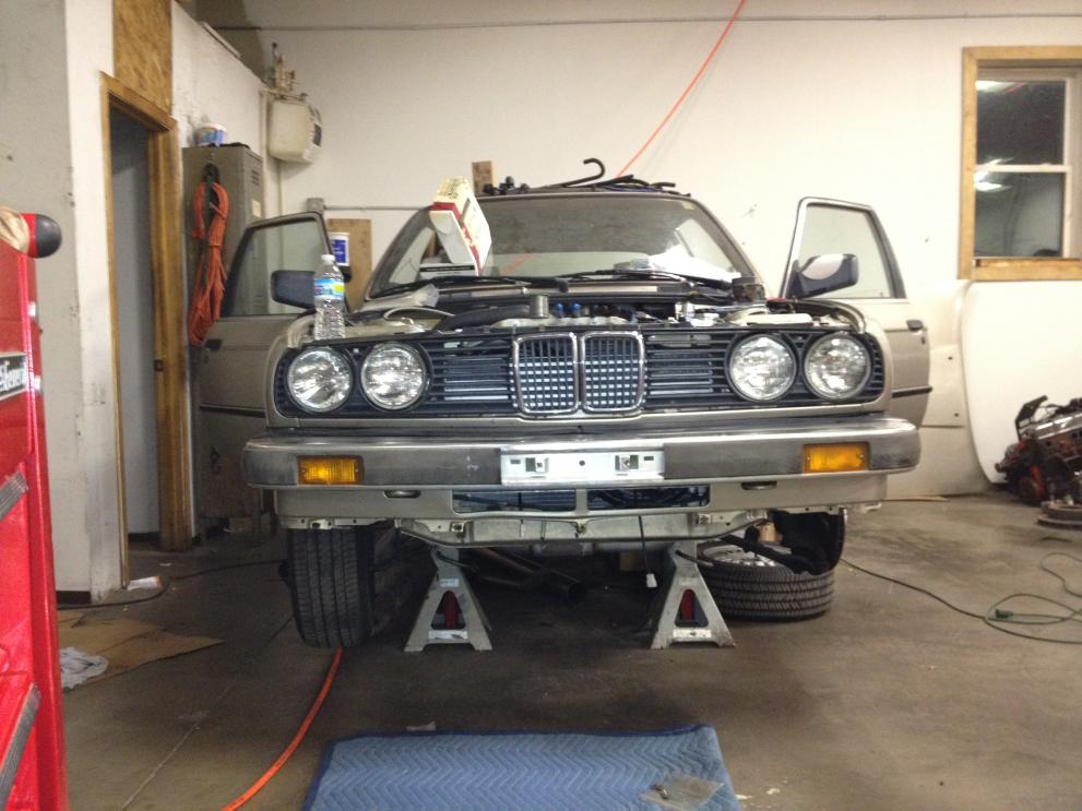

<p dir="auto">Upgrading the fuel lines was kind of a pain. I tried bending it out of 1/2" aluminum but lacked good benders that went that large. I felt like hard line was the safer way to go, but in working with that soft aluminum I wasn't convinced. In the end, I went with securely mounted braided stainless. The dual pump setup was ditched in favor of a Aeromotive 340 lph intank pump and a high flow, inline filter around the stock location. The stock fuel pump assembly on the 87 325e was a little different than the writeup I'd seen on the interwebs. We actually used pieces of two assemblies (cutting, welding, testing, etc.) to make something that looked sturdy and fit well.</p>
<p dir="auto">By this time, we've done a final installation of engine, tranny and custom driveshaft only to discover the trans is locked up. With the once piece driveshaft and the rear subframe encircling it, this hiccup is a big PITA. My brother-in-law's pop had squirreled away a practically new WC T5 with short shifter, so newer parts, wallet weight reduction, all good!</p>

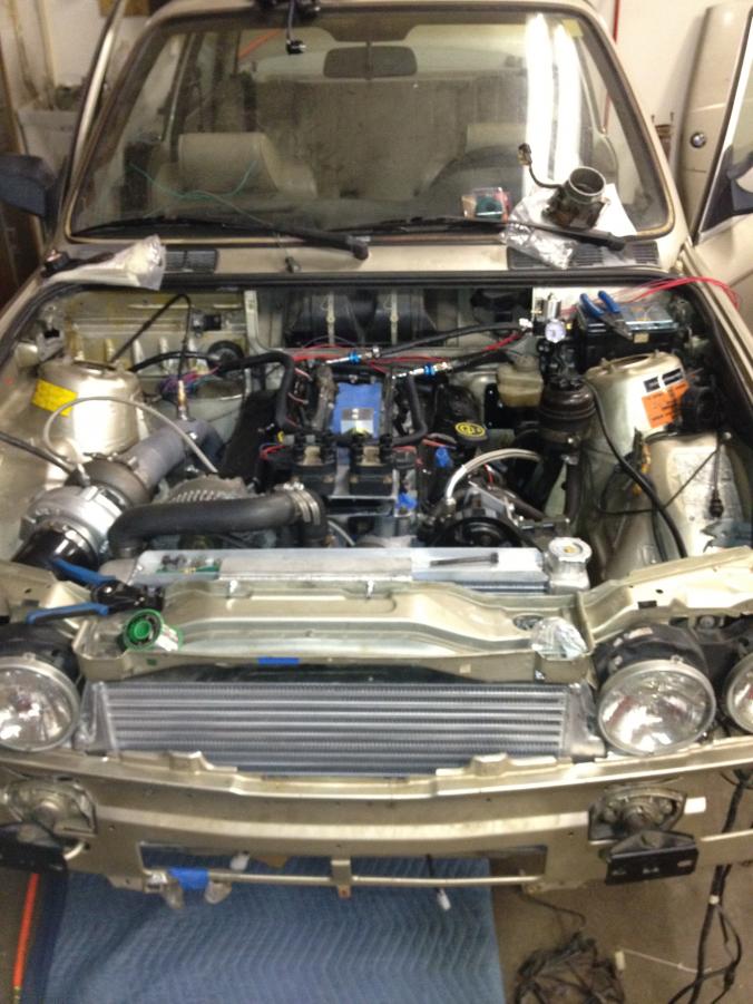

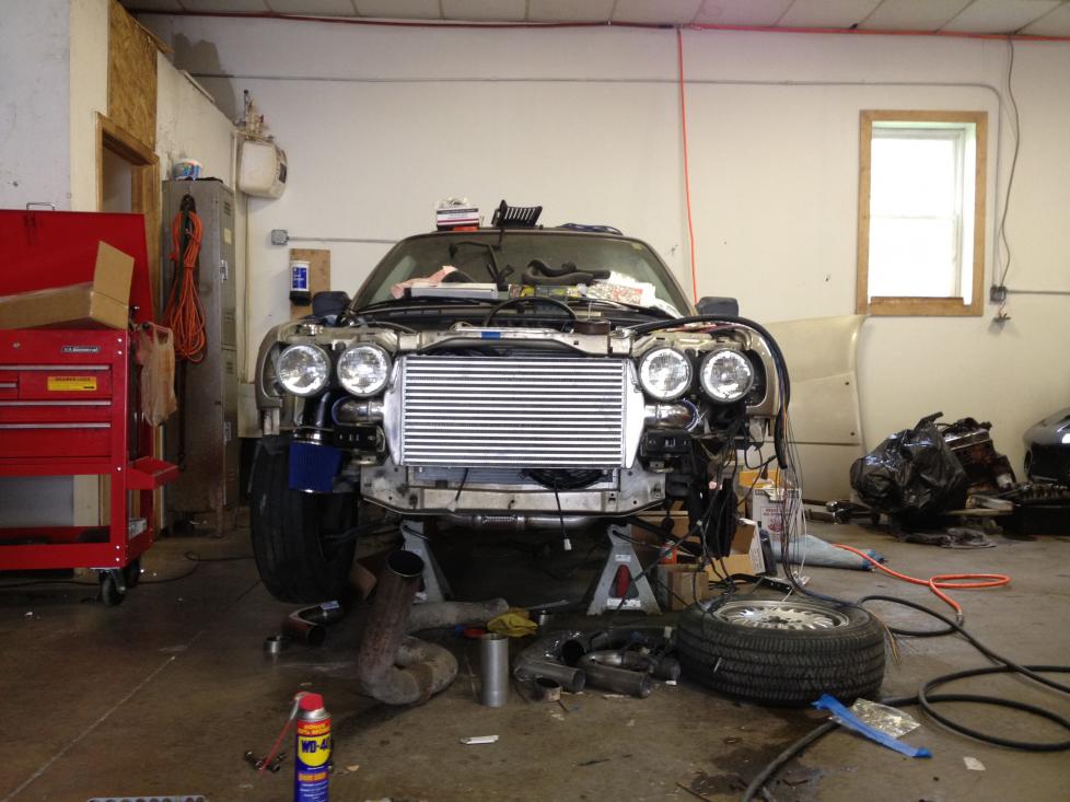

<p dir="auto">I will want to add the lower air damn to force more air through the FMIC and radiator. I am thinking about some ducting to split what goes through the FMIC (and not just spill down the front) and force what naturally goes below the FMIC into the radiator. Have to think this out though.</p>
<p dir="auto"><a href="/assets/uploads/files/monthly_02_2013_post-1582-136211551125.jpg"><img src="/assets/uploads/files/monthly_02_2013_post-1582-136211551125_thumb.jpg" alt="post-1582-136211551125thumb.jpg" class=" img-fluid img-markdown" width="563" height="750" /></a></p>
<p dir="auto"><a href="/assets/uploads/files/monthly_02_2013_post-1582-136211551131.jpg"><img src="/assets/uploads/files/monthly_02_2013_post-1582-136211551131_thumb.jpg" alt="post-1582-136211551131thumb.jpg" class=" img-fluid img-markdown" width="991" height="743" /></a></p>

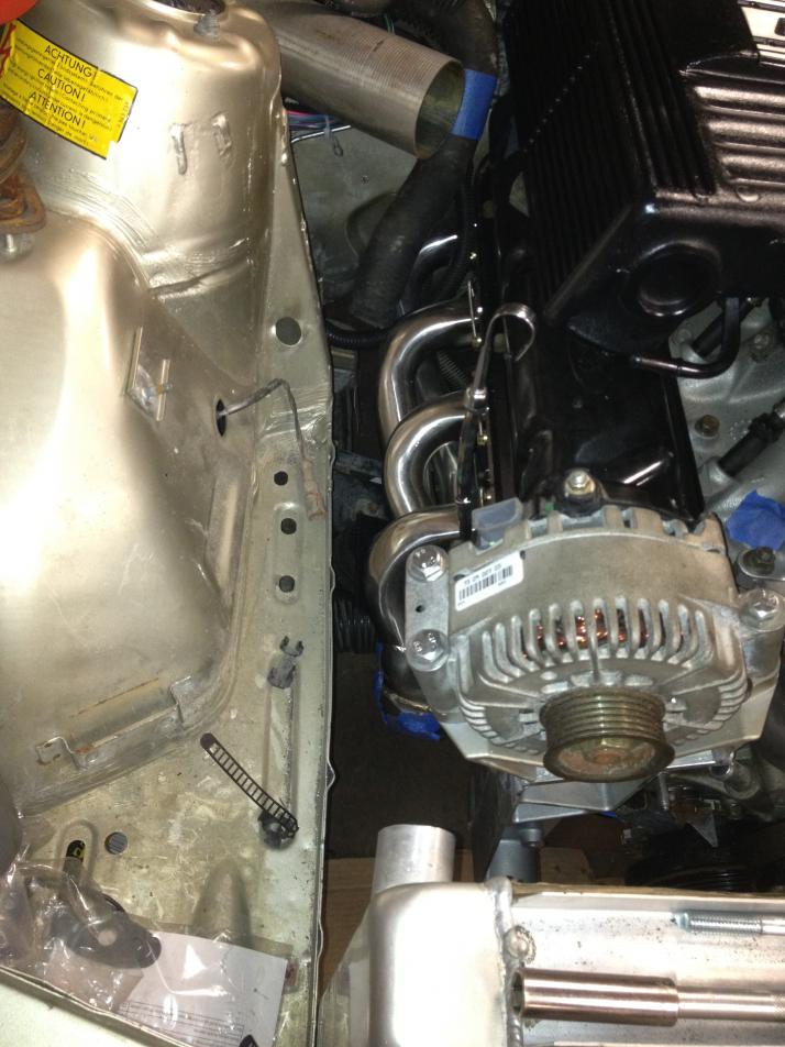

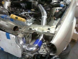

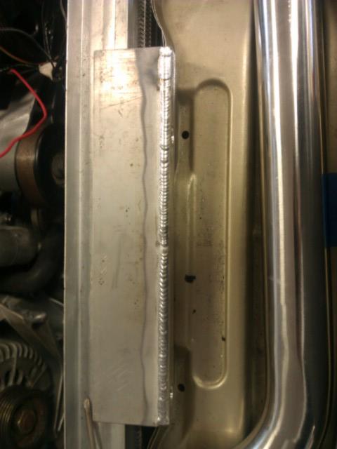

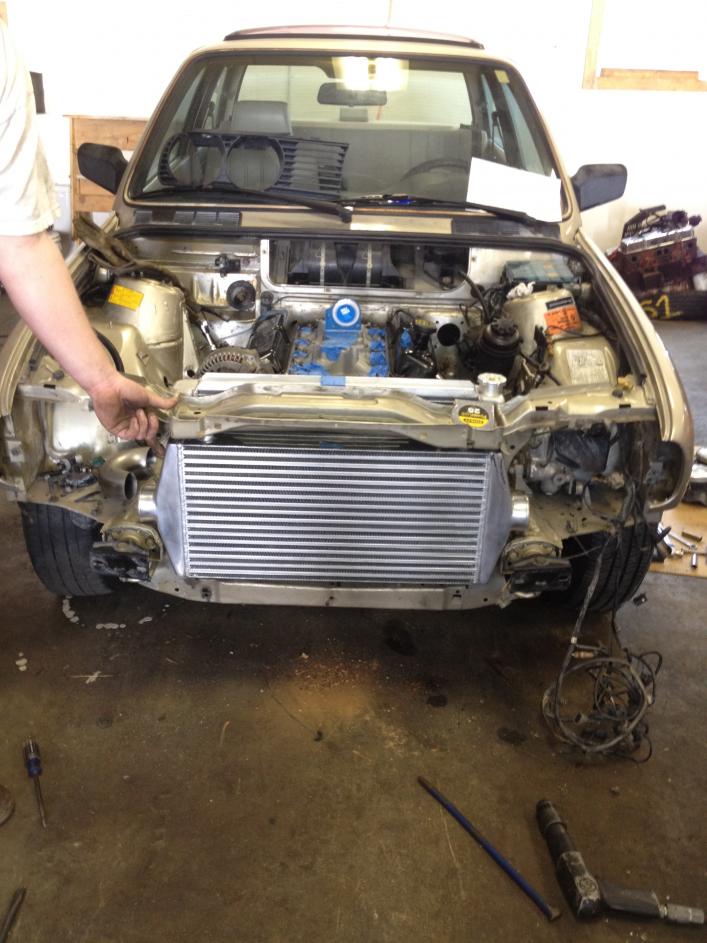

<p dir="auto">We also planned to flip the Ford 5.0 intake 180deg so the throttle body is on the driver's side. With a modification of the fuel rail (remove the FPR), the Cobra/GT40/Explorer intakes can do this pretty easy. This way the passenger side of the engine is downpipe, the driver's side is charge pipe. On the standard Mustang single-turbo everything is jammed in on the passenger side. I like this altrnative routing.</p>

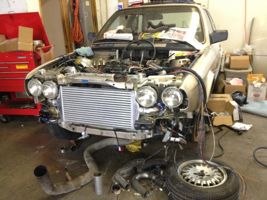

<p dir="auto">The best path seemed like a big eBay intercooler with some modifications to the end tanks (to fit the headlights) and welded on elbows. 2.75" piping + couplers added that much more interference with the headlight baskets so going hardpipe off the endtank saved a tiny bit. The cast elbows look cool too, IMHO.</p>
<p dir="auto"><a href="/assets/uploads/files/monthly_02_2013_post-1582-136211551082.jpg"><img src="/assets/uploads/files/monthly_02_2013_post-1582-136211551082_thumb.jpg" alt="post-1582-136211551082thumb.jpg" class=" img-fluid img-markdown" width="977" height="733" /></a></p>
<p dir="auto"><a href="/assets/uploads/files/monthly_02_2013_post-1582-136211551091.jpg"><img src="/assets/uploads/files/monthly_02_2013_post-1582-136211551091_thumb.jpg" alt="post-1582-136211551091thumb.jpg" class=" img-fluid img-markdown" width="563" height="750" /></a></p>
<p dir="auto"><a href="/assets/uploads/files/monthly_02_2013_post-1582-136211551105.jpg"><img src="/assets/uploads/files/monthly_02_2013_post-1582-136211551105_thumb.jpg" alt="post-1582-136211551105thumb.jpg" class=" img-fluid img-markdown" width="895" height="671" /></a></p>

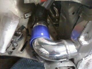

<p dir="auto">More handiwork with charge piping... lots of aluminum welding.</p>
<p dir="auto"><a href="/assets/uploads/files/monthly_02_2013_post-1582-136211551112.jpg"><img src="/assets/uploads/files/monthly_02_2013_post-1582-136211551112_thumb.jpg" alt="post-1582-136211551112thumb.jpg" class=" img-fluid img-markdown" width="320" height="240" /></a></p>
<p dir="auto"><a href="/assets/uploads/files/monthly_02_2013_post-1582-136211551114.jpg"><img src="/assets/uploads/files/monthly_02_2013_post-1582-136211551114_thumb.jpg" alt="post-1582-136211551114thumb.jpg" class=" img-fluid img-markdown" width="320" height="240" /></a></p>
<p dir="auto"><a href="/assets/uploads/files/monthly_02_2013_post-1582-136211551116.jpg"><img src="/assets/uploads/files/monthly_02_2013_post-1582-136211551116_thumb.jpg" alt="post-1582-136211551116thumb.jpg" class=" img-fluid img-markdown" width="978" height="733" /></a></p>

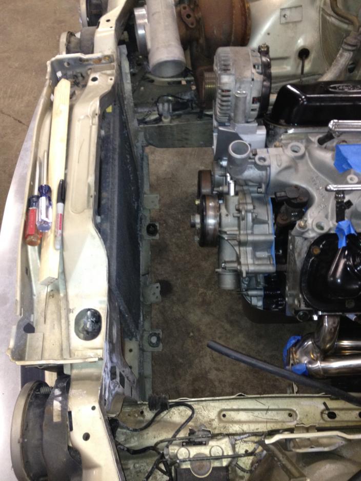

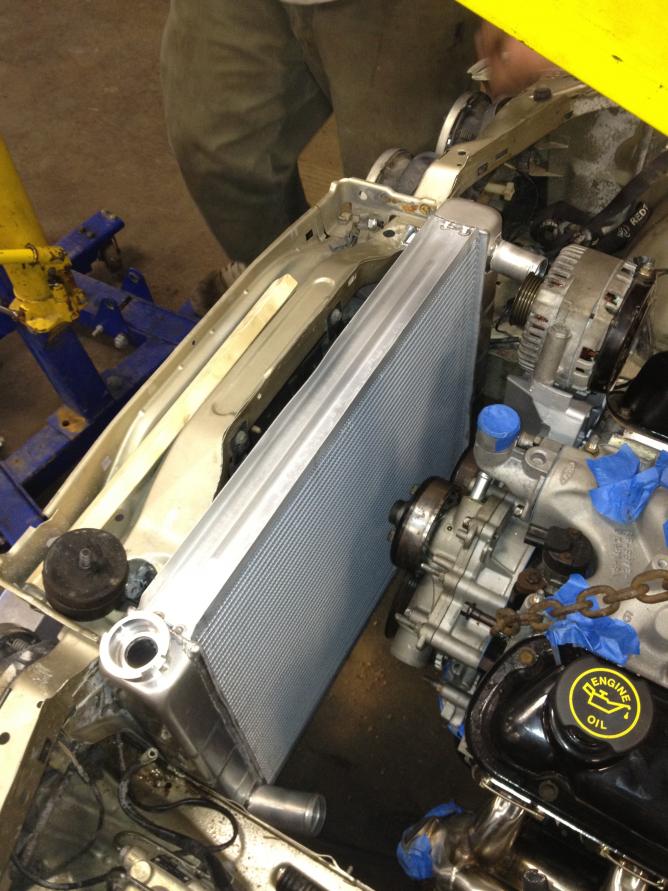

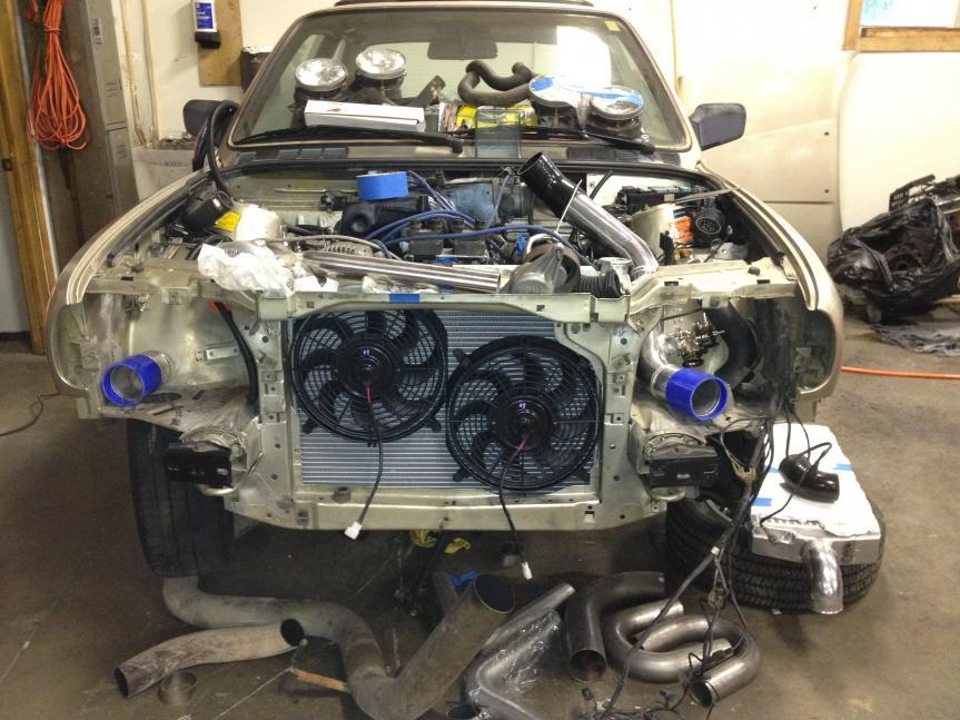

<p dir="auto">To prep, I found the thinnest fans with the biggest diameter I could find. I trimmed the core support just a bit (and repainted) and attached the two fans. I can still pull the radiator, with the fans attached out through the engine bay if the top radiator hose is removed.</p>
<p dir="auto"><a href="/assets/uploads/files/monthly_02_2013_post-1582-136211551053.jpg"><img src="/assets/uploads/files/monthly_02_2013_post-1582-136211551053_thumb.jpg" alt="post-1582-136211551053thumb.jpg" class=" img-fluid img-markdown" width="563" height="750" /></a></p>
<p dir="auto"><a href="/assets/uploads/files/monthly_02_2013_post-1582-136211551062.jpg"><img src="/assets/uploads/files/monthly_02_2013_post-1582-136211551062_thumb.jpg" alt="post-1582-136211551062thumb.jpg" class=" img-fluid img-markdown" width="863" height="647" /></a></p>
<p dir="auto">My buddy fabbed a simple upper radiator bracket (rubber underneath; not bolted to the core support in this pic) and we added a little foam between the endtanks and the back of the core support to help direct air through rather than around the sides. Still need to think about directing air through on the bottom as you will see later the bottom of the radiator is the one part that is unobstructed by the FMIC.</p>
<p dir="auto"><a href="/assets/uploads/files/monthly_02_2013_post-1582-13621155107.jpg"><img src="/assets/uploads/files/monthly_02_2013_post-1582-13621155107_thumb.jpg" alt="post-1582-13621155107thumb.jpg" class=" img-fluid img-markdown" width="480" height="640" /></a></p>

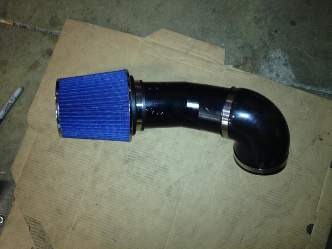

<p dir="auto">Also, a simple 4" cold air intake was made. Picking up air from in front of the wheel well. The bracket to support the turbo weight can also be seen.</p>
<p dir="auto"><a href="/assets/uploads/files/monthly_02_2013_post-1582-136211551038.jpg"><img src="/assets/uploads/files/monthly_02_2013_post-1582-136211551038_thumb.jpg" alt="post-1582-136211551038thumb.jpg" class=" img-fluid img-markdown" width="1000" height="751" /></a></p>

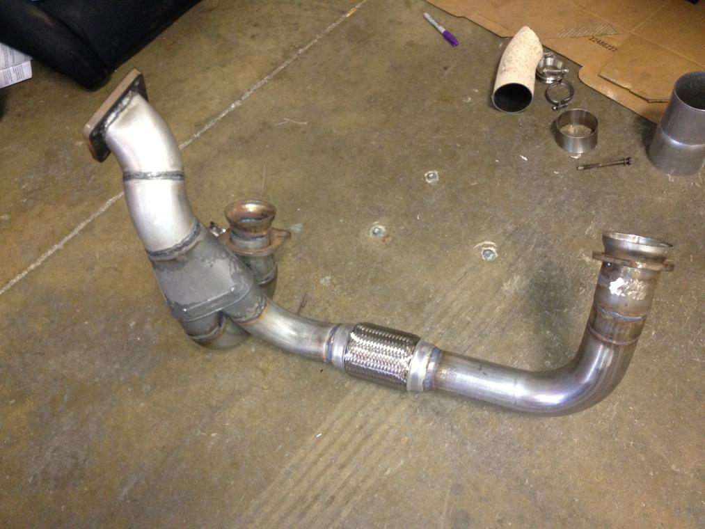

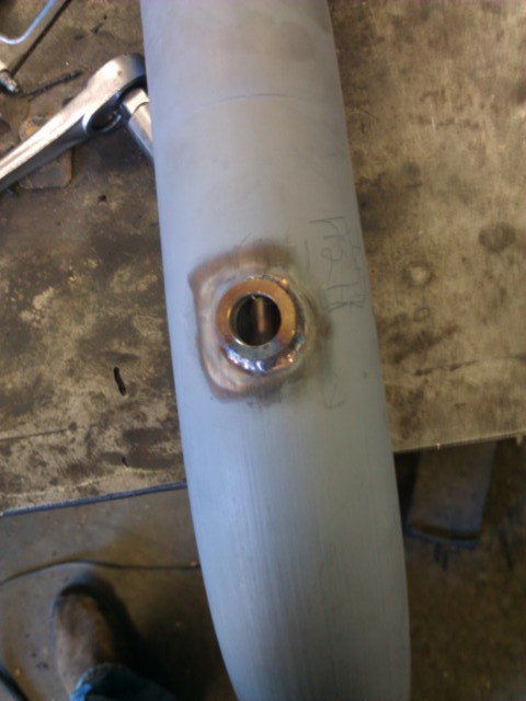

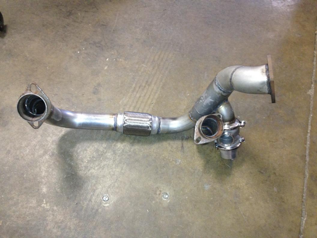

<p dir="auto">A 3" downpipe was made and a bung added for the wideband. Down below this goes to 3.5" and eventually the wastegate will merge in there just before heading into the trans tunnel.</p>
<p dir="auto"><a href="/assets/uploads/files/monthly_02_2013_post-1582-136211551048.jpg"><img src="/assets/uploads/files/monthly_02_2013_post-1582-136211551048_thumb.jpg" alt="post-1582-136211551048thumb.jpg" class=" img-fluid img-markdown" width="480" height="640" /></a></p>

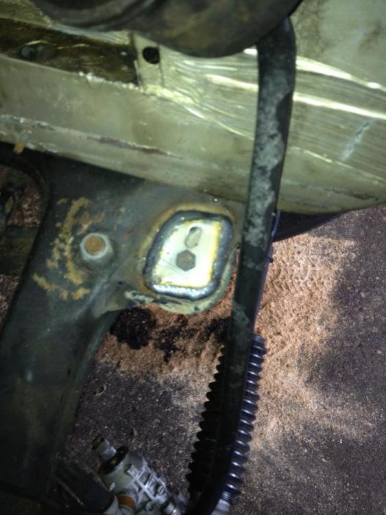

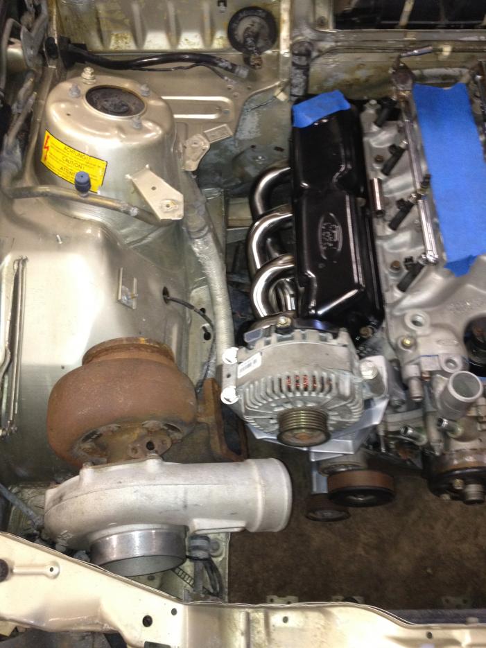

<p dir="auto"><a href="/assets/uploads/files/monthly_02_2013_post-1582-136211550966.jpg"><img src="/assets/uploads/files/monthly_02_2013_post-1582-136211550966_thumb.jpg" alt="post-1582-136211550966thumb.jpg" class=" img-fluid img-markdown" width="563" height="750" /></a></p>

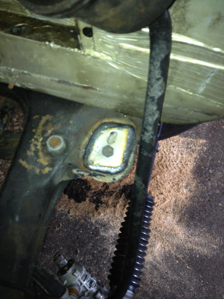

<p dir="auto">We ended up cutting and adjusting the motor mount adapters provided by Matt (<a href="http://E30v8.com/e36v8.com" rel="nofollow ugc">E30v8.com/e36v8.com</a>) to get the engine position a little better. Also added a couple gussets to each for a little more strength (piece of mind... and we had the welder out anyway). The first test fits were used to understand how much room might be available for the turbo on the passenger side and fans/radiator.</p>

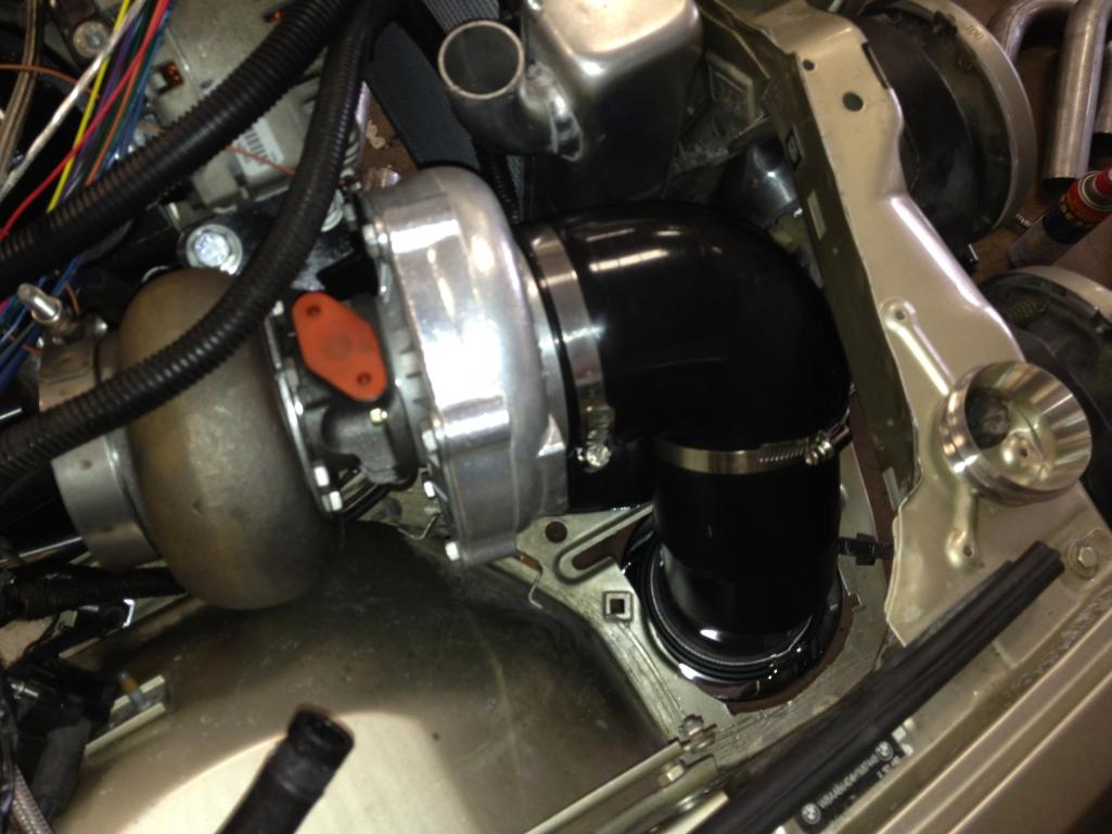

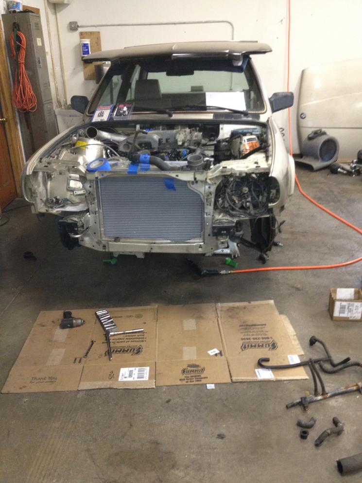

<p dir="auto">For the radiator, the first one I selected fit OK but was a bit small. I found this big 3-row, all-welded aluminum radiator at Summit. It fit with a little massaging of the framerails, modifying the inlet/outlet and repositioning of the lower supports further down on the backside of the radiator core support. By using the Explorer accessory brackets, as suggested by Matt, there is nice room between the nose of the water pump and the radiator. Without fans it actually looks roomy.</p>
<p dir="auto">For the turbo, things were going to be tighter than desired. Although the monster turbo in the picture wasn't to be used, it was still clear that there would be minimal room between a blazing hot turbine and the alternator and its wiring. The solution was to chop the top of the alternator bracket off, weld on a plate, and move the top of the bracket 1-2" towards the center. It is subtle (in the pic below you can see the alternator is now inline with the headers), but I think it is one of the challenges to be addressed with the smaller engine bay of the e30. I don't think we would have done this with an e36.</p>
<p dir="auto"><a href="/assets/uploads/files/monthly_02_2013_post-1582-136211551006.jpg"><img src="/assets/uploads/files/monthly_02_2013_post-1582-136211551006_thumb.jpg" alt="post-1582-136211551006thumb.jpg" class=" img-fluid img-markdown" width="563" height="750" /></a></p>
<p dir="auto">This is one of a bunch of little modifications that makes me so grateful for the two competent guys helping make this project happen.</p>

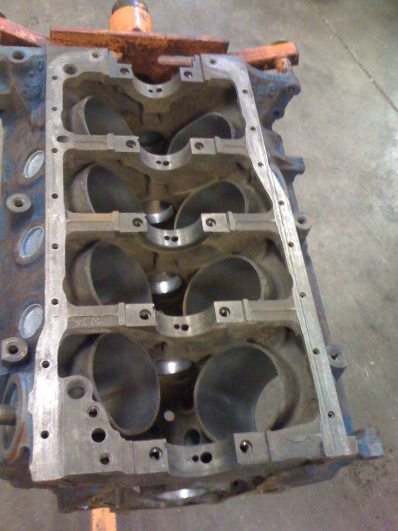

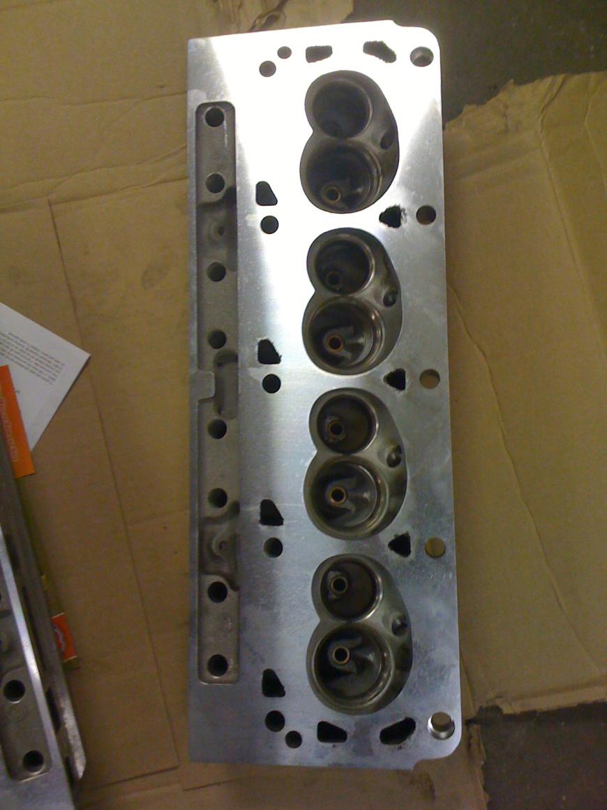

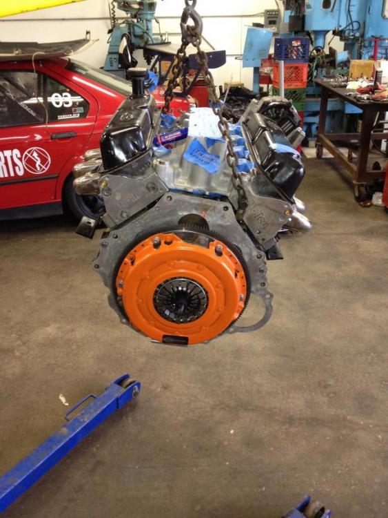

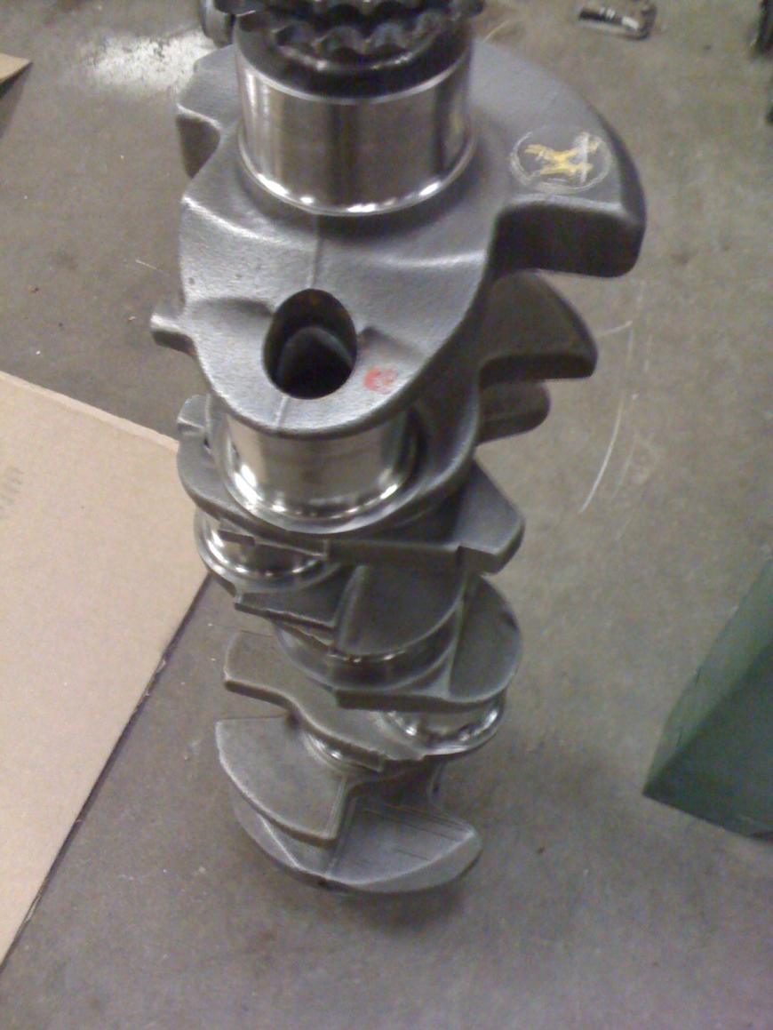

<p dir="auto"><a href="/assets/uploads/files/monthly_02_2013_post-1582-136211550897.jpg"><img src="/assets/uploads/files/monthly_02_2013_post-1582-136211550897_thumb.jpg" alt="post-1582-136211550897thumb.jpg" class=" img-fluid img-markdown" width="563" height="750" /></a></p>
<p dir="auto"><a href="/assets/uploads/files/monthly_02_2013_post-1582-136211550913.jpg"><img src="/assets/uploads/files/monthly_02_2013_post-1582-136211550913_thumb.jpg" alt="post-1582-136211550913thumb.jpg" class=" img-fluid img-markdown" width="563" height="750" /></a></p>
<p dir="auto"><a href="/assets/uploads/files/monthly_02_2013_post-1582-136211550926.jpg"><img src="/assets/uploads/files/monthly_02_2013_post-1582-136211550926_thumb.jpg" alt="post-1582-136211550926thumb.jpg" class=" img-fluid img-markdown" width="563" height="750" /></a></p>

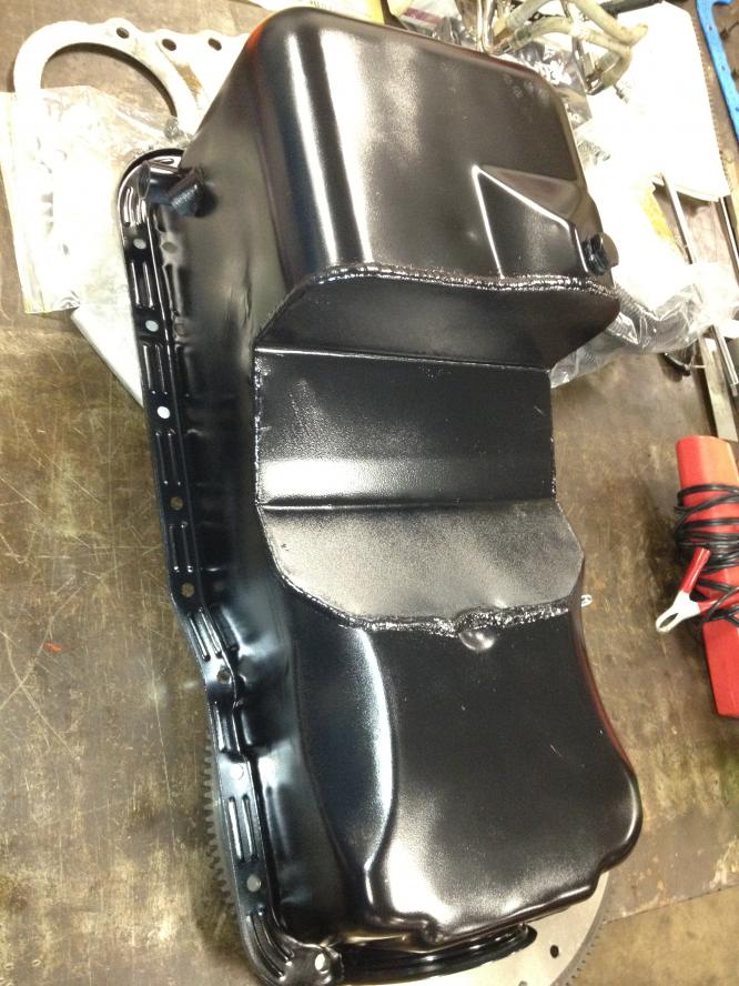

<p dir="auto">Pan from Matt at e36v8 modified to include an internal baffle and a dipstick and turbo oil return bung. Had to modify the rec. oil pick-up tube to fit this pan. Added a windage tray and upgraded oil pump. ARP hardware.</p>
<p dir="auto"><a href="/assets/uploads/files/monthly_02_2013_post-1582-136211550936.jpg"><img src="/assets/uploads/files/monthly_02_2013_post-1582-136211550936_thumb.jpg" alt="post-1582-136211550936thumb.jpg" class=" img-fluid img-markdown" width="563" height="750" /></a></p>
<p dir="auto">Mostly assembled engine awaiting last bits and trans (5.0L e36 track car in background). Fairly stock rebuild specs... planning for lower boost and reasonable RPMs. If all goes well, a hot rod short block will be built up in the future. This was spring of '12 by this point.</p>

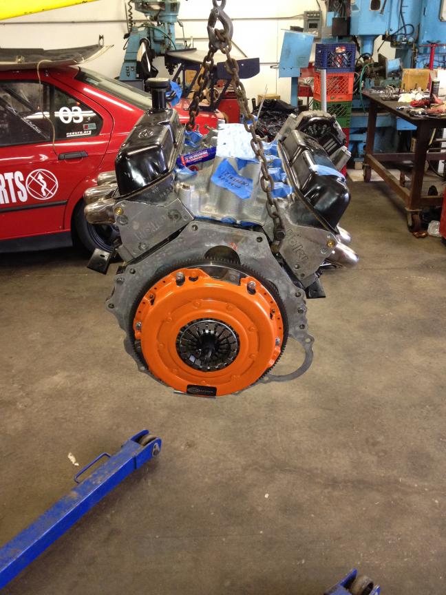

<p dir="auto"><a href="/assets/uploads/files/monthly_02_2013_post-1582-136211550943.jpg"><img src="/assets/uploads/files/monthly_02_2013_post-1582-136211550943_thumb.jpg" alt="post-1582-136211550943thumb.jpg" class=" img-fluid img-markdown" width="563" height="750" /></a></p>
<p dir="auto">This is my kiddo disassembling T5 #1 (which ended up being junk).</p>
