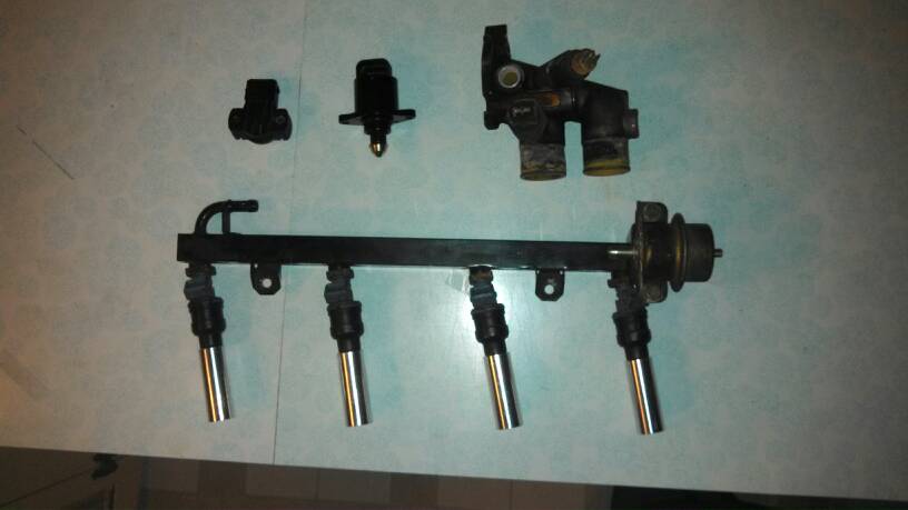

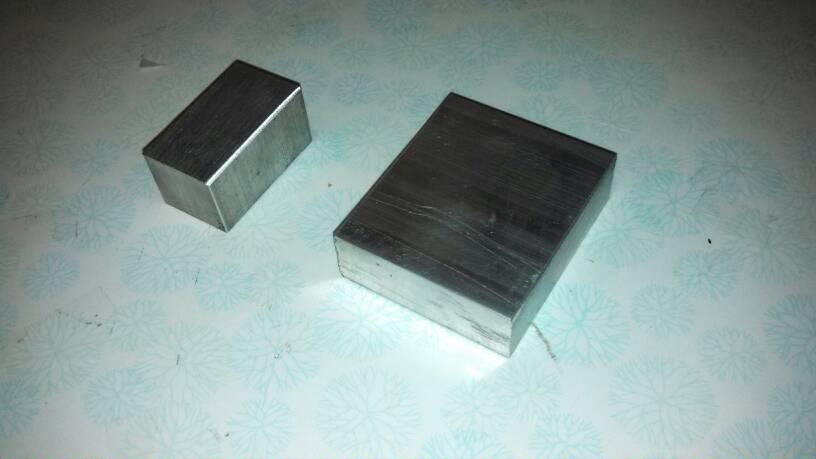

<p dir="auto">I also have been collecting parts for work that will be done such as EDIS-4 parts from an escort to convert to electronic ignition</p>
<p dir="auto"><img src="http://i144.photobucket.com/albums/r175/bassboy3313/e312e5b1dd81_1a703468-17a0-48df-a12a-9cece764632fth450tw610.jpg" alt="Posted Image" class=" img-fluid img-markdown" /></p>
<p dir="auto">s14 oil filter housing tapped for oil supply to turbo (so I can get rid of this stupid sandwich plate), ARP head studs, and an e12 throttle body for more air flow.</p>
